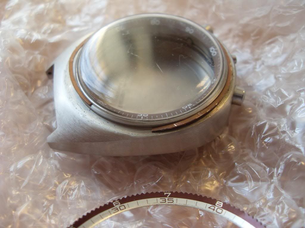

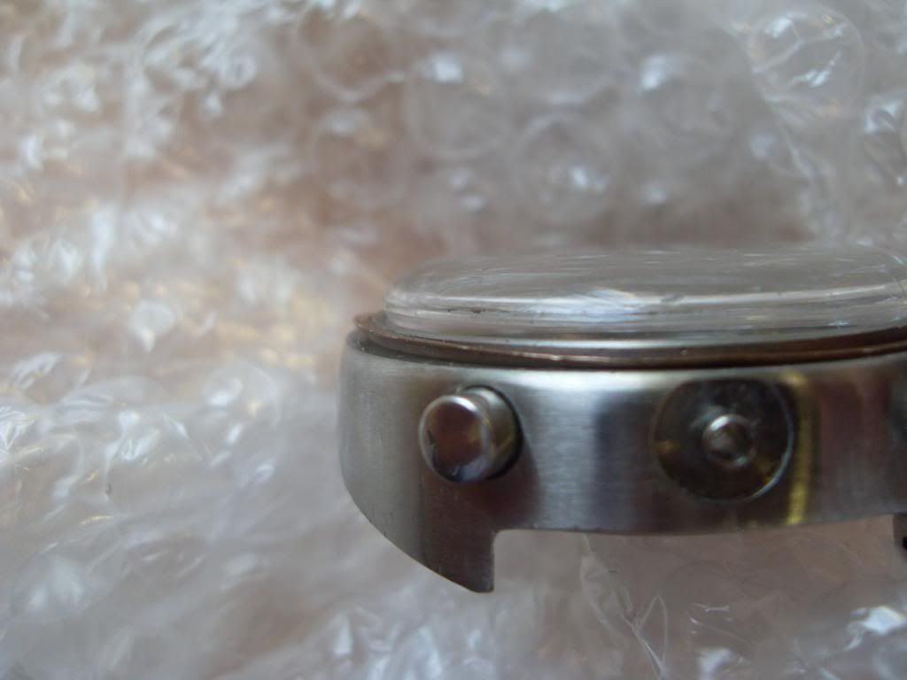

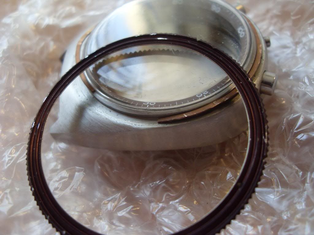

Hot off the press. I have managed to get the proposed bezel off the case (see 3 photos below). As you can see, there is a partial retaining spring, grooves to the underside of the bezel and an associated lip on the crystal. Fingers cossed that I can safely do that to the original and then safely squeeze the new one on!!!

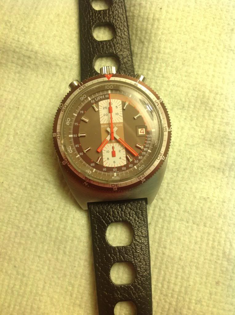

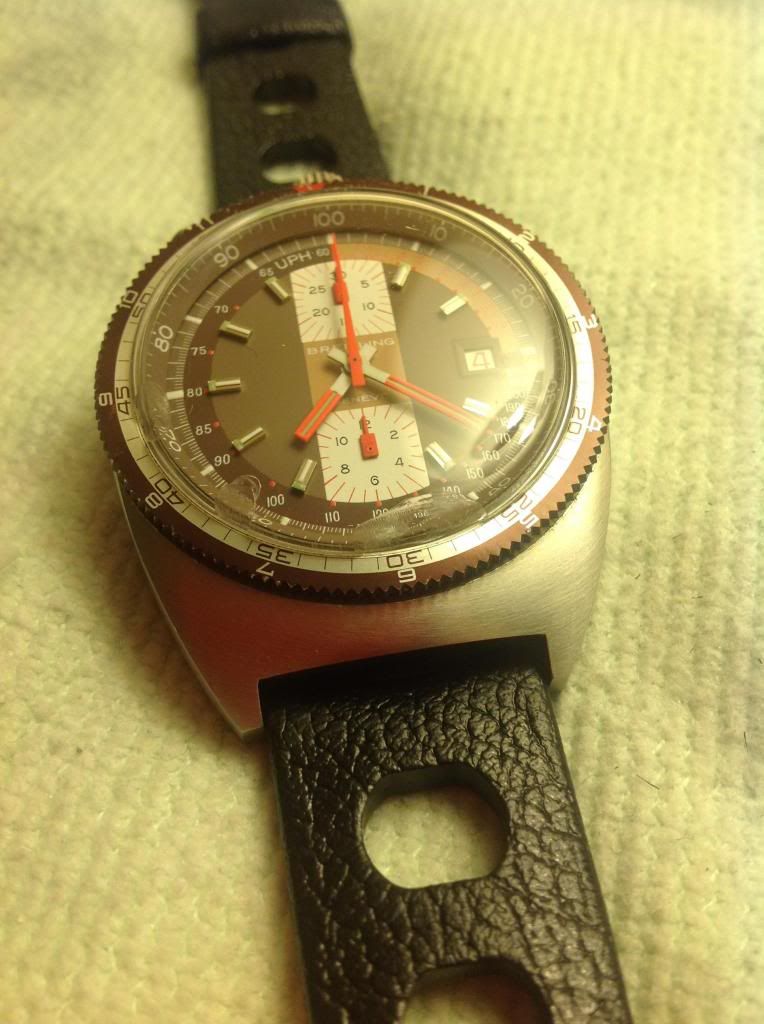

Got the old bezel off requiring great effort, not sure if it was marginally a smaller diameter ? Anyway it came off but so did three chunks of crystal. It was on so tight that when the bezel was pushed upwards, the crystal lip sheared in three places as can be seen from the first photo.

Except for the damaged crystal, hope you agree that my slightly damaged Pupitre looks great!

Yes, your Pupitre looks beautiful and given the crystal damage aside, I think its one of the best I have ever seen.
Shame about the crystal coming off, but you will find replacing the crystal much easier than the bezel. I was going to suggest that slipping is an issue and I avoid the push peice and crown area when disassembling. Looks like you might have had the same idea, as the damage is at the 6 o clock area.
I must admit, I have not seem a bezel clip quite like that, and I assume the notches are to create a ratcheting of the bezel as its turned. Very, very hard in the design of the bezel to do exactly as you have done, ie:- clip the ring onto the watch. So well done. Most wire type clips are designed to pass through a tolerance gap and expand into the groove it is designed for. In this case, I am left wondering how the bezel is to come off easily in the first place. Very unusual design and the shape is part of the retention arrnagement, but also makes it very hard toassemble/disassemble.
