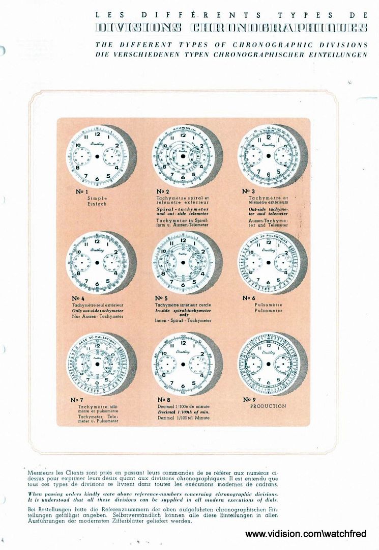

nice dials - and these "spiral" dials in diffent configurations were options on all 1940s models.
would have like to see more/better pics of both watches shown, including casebacks;
is there a bridge engraving on watch 1 ?
here's the dial option page from the 1946 catalog:

@Fred I know this dial option page...the dial design..if it is genuine...must have been dropped by then.

how was it "made out to be from 38", please ?
also what do you mean "dropped by then", again, the spiral dials were options on all models at least until the 46 catalog ?
happy to answer questions, but I'd need to understand what you are asking ?

Regarding the dial design: I didn't mean to say that the Spiral design was dropped from the product range by 46, but that the dial pictured above seemed not to have been produced anymore by 46.
Does that make sense?

well, would be very hesitant to quote a production date somebody "claimed" - nothing here points to a specific production year. asking again, is that an engraving on the bridge ?
no reason also to believe that dial was not in production in 1946 ?
