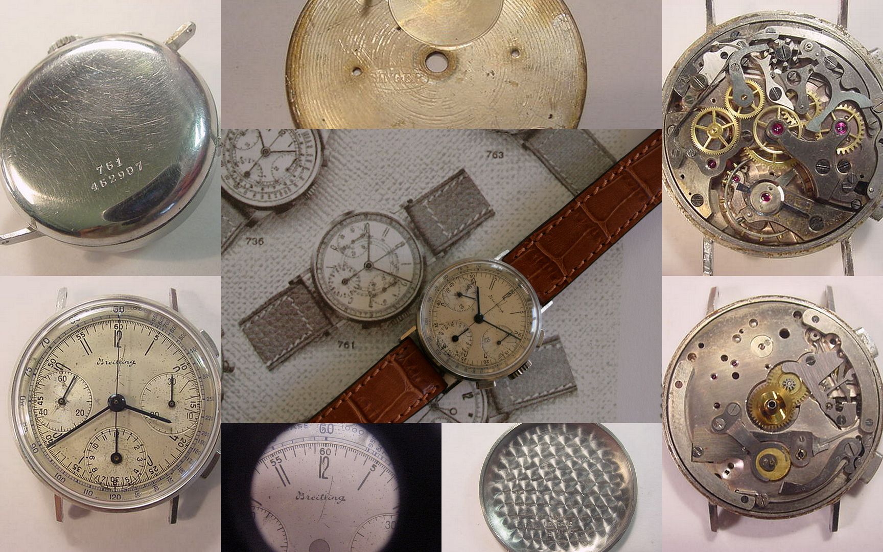

Some months ago Phil (member Saabreit) was kind enough to send me excellent scans of some early 1940s Breitling catalogs; some weeks later a watch was listed out of the UK that I had never seen before, a ref. 761 - pictured on page 11 of the 1942 catalog, non-working, but in quite acceptable condition.
Excitedly pm'ed a well known member - held my fingers crossed and won the auction. As my early 40s ref. 734 has the "old" rounded Venus 178 bridge I just had a cursory look at the movement pics, but when I emailed Craig - who looks at movements, not catalog pictures - he informed me it was a Landeron 42, the tricompax version of the Landeron 39.
I am convinced the watch is correct & authentic and so is Craig, who had to work his miracles with this one:
" ... started on the 761 today. I wanted to install the balance 1st but the one I bought for it had a flat spring and yours is a Breguet spring - not interchangeable unless the regulator is changed so I restaffed the old one and its running and keeping time (chrono function not engaged) now even though I have not cleaned it yet. Off to a good start for a Landeron 42.
I took a bunch of pics to you could see some more details. The Breitling script is interesting in that it is the same as the script on Paul's 3 pusher Landeron (a movement that is not in my books). It is slightly different and/or smaller than later script signatures but it looks real for sure. This dial is original for a L42 and has never been changed or altered.
I do not plan to do anything with this dial given its rarity. The only mark on the movement is KXF on the balance bridge which is a Zodiac/Clebar import code. Regardless, the watch appears to be completely original including the crystal and crown.
Hopefully there will be someone out there someday that knows the real story behind these Landeron Breitlings."
"update on the 761.... One of the chrono bridge jewels was cracked and came apart when I removed it - see attached pic.
Have one on order. Had to spend over 2 hours today to get the hour counter operational. The direct drive off the mainspring barrel cap was loose and had to be tightened. The biggest problem was a part that was missing the disengages the hour counter when the second sweep is stopped. I knew that I would probably never find another one so I made one.
This is only the 3rd Landeron 42 I have worked on in 12 years - they are very rare and parts are non existent. In fact, you can't find this movement in any watch books and Best Fit does not list any part even though the acknowledge that it was made."
"I finished your 761 today. This was one of the biggest and most complex projects I have done in quite a while (Rene's 2005 was bigger). I have only worked on 3 Landeron 42s in 12 years and everyone was a bitch to work on. They come apart and go together like a 3 dimensional jigsaw puzzle.
Access to simple things on most chronograph movements is not the case with this one and the hour counter mechanism is like no other. Whoever had it apart in the past circled the hole where the missing hour part went through the movement (inside the case halves) so I suspect they knew they had a problem? Regardless, this was a great original starter watch that has never been molested. Its done and running perfectly! "
here it is: :D

It was a pleasure to work on this one regardless of the missing part(s). The last Landeron 42 (Chronographe Suisse) that I worked on a couple of years ago was in horrible condition. This one had not been molested. Some of the most dreadful projects are watches that have had really poor prior service/repairs making it near impossible to figure out what was done to make them run and operate so badly.
I hope to see more of these early signed dials with this script in the future. It is different than the later 40s/50s script. Finding someone with 1st hand knowledge of really early Breitlings like this would be difficult given the fact that they would probably be in their 90s if they were still alive.

Interesting to notice that the ref. 761 is completely made from stainless steel, not chromed base metal, a material Breitling typically only used for the high end watches that later were branded Premier.

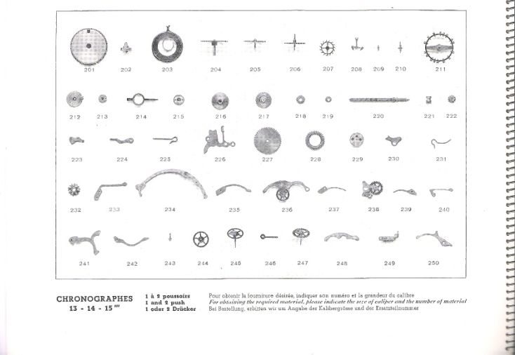

Below is a parts page from the Breitling 1942 catalog, according to invenetfecit these are Landeron 39 (and 42, I assume) parts, maybe Craig can verify this ?

With regard to the pic of the Landeron movement parts, only the cal 39 parts are shown. Note on Fred's movement pictures that the 42 has a special long tension spring for the coupling clutch (upper left side - open hole below it for the 39 spring attachment) that is only used on the 42 and not shown with the parts. Also, none of the top side parts are shown like the hour wheel and parts that operate it. So far I have been unable to find any illustrations of any of the additional cal 42 parts.
