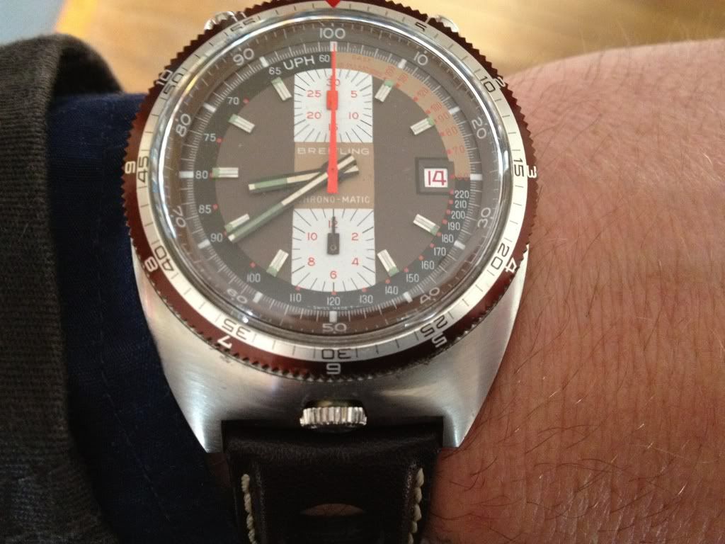

PostPosted: Thu Jul 19, 2012 1:20 am
Can't really go with Bill on that one. I think the pult's great. I wanted one for years nd finally snagged mine last year. As others have said there are plenty of the manual wind ones around (a lot of which are frankens) but fewer of the chronomatics. I love mine.
