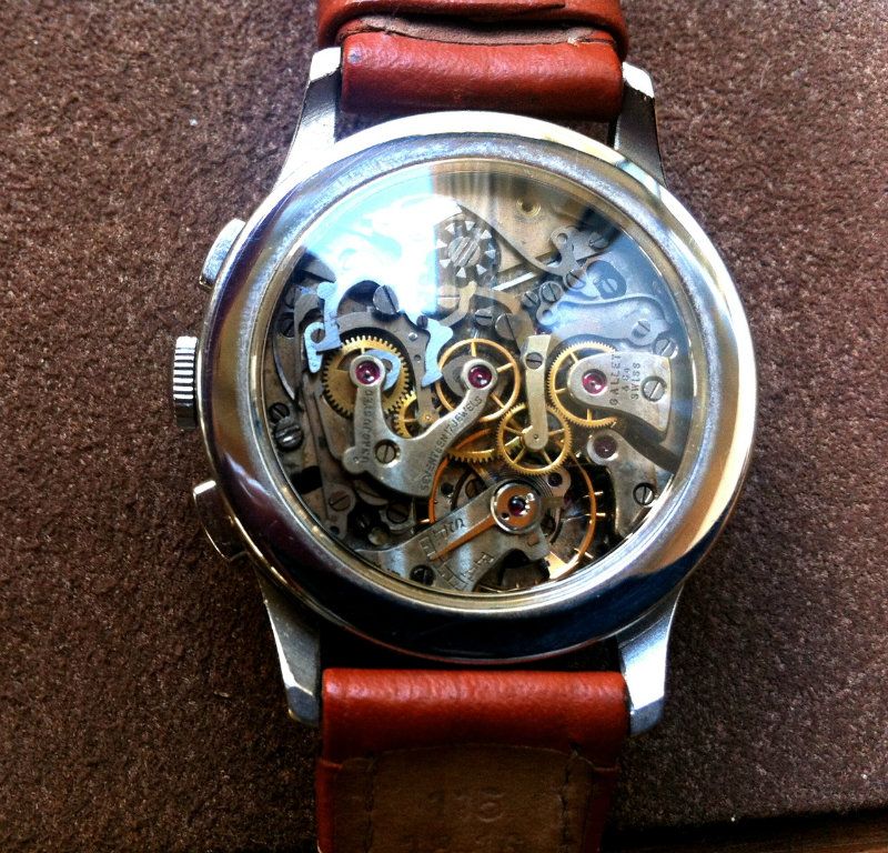

I do have a Gallet with a display back fabbed by a US watchmaker, as I love those Excelsior park movement very much:
PostPosted: Mon Jun 18, 2012 3:57 am
Didn't realise that Preik was still doing it - though I prefer mine original.
That EP movement is rather nice, a worthy upgrade for the Gallet.
Wow, that transparent caseback is stunning my friend!
