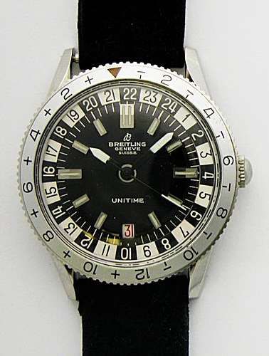

do not have my books and watches with me, but the second Unitime model was ref. 2160, definitely produced into the mid 1960s. You are confusing this with the ref. 1765 Unitime, a variant of the AVI, with 24 hour dial and turning bezel, not a worldtimer in the strict sense.

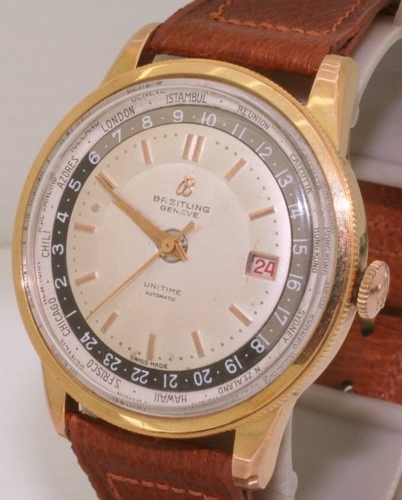

here is a ref. 2160 Unitime Worldtimer

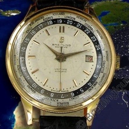

Well, TeamTom,
this only shows how much the "reps" at Breitling HQ know, did you speak to the janitor ?
you might show them the following ad from 1956 or 1957, believe it also is in "The Book",
so they will not have to search for too long:
or this ad from a Swiss Magazine, dated 1957:
but maybe they want additional proof ?

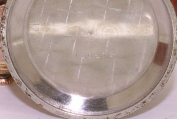

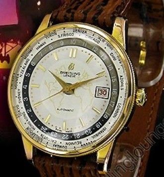

here is a watch from 1952:
and two from 1955:
if they are unsure about dating them, here is a link to the serial numbers, right column, non-chrono:
http://www.vidision.com/watchfred/
sorry for sounding a bit .... unhappy and slightly miffed, this is not towards you, but Breitling; the lack of
knowledge and respect for the brand heritage is really quite disappointing, and it does show in
the design quality of those "Tribute" watches.

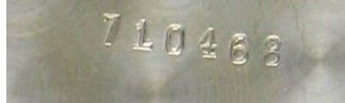

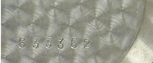

PostPosted: Thu May 10, 2012 1:42 pm
dated to the 50ies somewhere , I have to open it to have a look at the serial
but these we're made for more than a single year and with a worldmap they are early (1st?) versions
I am not quite sure (yet) how the chronology works but there are different versions :
25 jewel world map versions in 18K , plated and SS
27 jewel world map versions in 18K , plated and SS
17 J black dial versions with (as far as I recall) at least 3 different bezel layouts and bezel materials
so at least 5 versions made from the early 50ies to the mid 60ies
