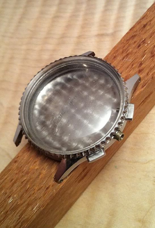

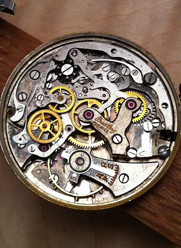

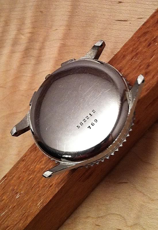

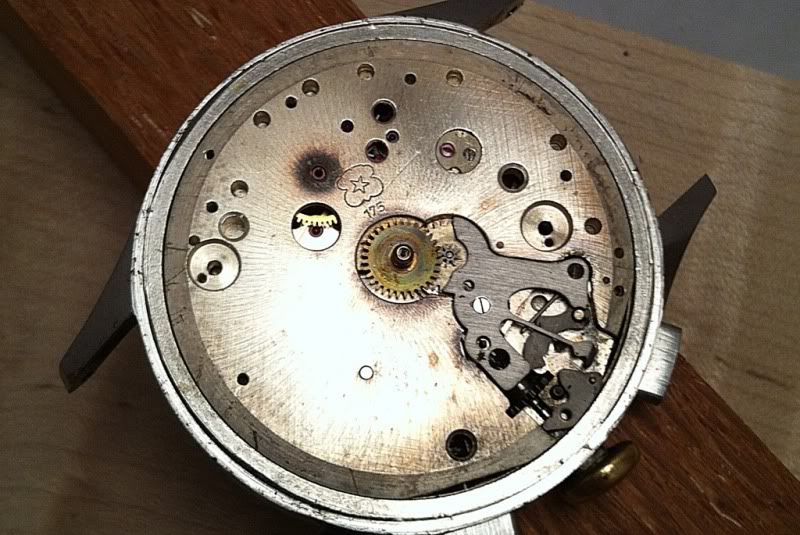

I found this all in separate pieces and in different boxes of parts and junk. The middle case was first. It already had me screaming on the inside because I immediately knew it was a Breitling case after my last project '43 ref. 178 came together. The digging became much more intense at that point and within a few seconds I had found the case back. Hmmm ... not the ref. number I expected to see. The shop owner had been through this box and missed them both. I continued digging, now with even more purpose, for an hour. When I was sure I had overturned every scrap in the little boxes I had to look through, I pestered the owner about any other old chrono parts he may have about. Now, I do this every time I see him. Sometimes he has some, but usually not handy. This time he also said he might but nothing laying about that he could get to at the moment. I guess I hung around long enough for his memory to kick back in. As I was about to head out he stopped me and went back into his workshop room. A moment later he came out with a bezel and two movements. Not just any bezel ... THE bezel. I knew it instantly and was almost jumping up and down. I was so excited about the bezel, I didn't look at the movements closely for probably another 20 minutes as we talked about the case that was now complete. When I finally did, I nearly lost it. How crazy could it get? There before me was a 99% complete Venus 175. This couldn't be happening. Needless to say, I convinced him to let me look through a few boxes of dials after that. Unfortunately my lucky streak had ended there, and after my quick stop had turned into a 3 hour treasure hunt, I was off with a hand full of goodies.
So. Here is sit with a nearly complete piece of history in my hands. But now what? Where on this earth am I going to find the two most important pieces to my puzzle? Finding a needle in a haystack blindfolded seems to be an easier task. I realize my chances are nearly the same as picking the winning lotto numbers. Will I give up? Not on your life!!
I have to ask the stupid question. If I don't, I would be an idiot. I know the answers I expect to hear, but it must be asked regardless.
Can anyone suggest where in the world I might find an original dial and inner slide rule bezel for a 1945 Chronomat 769? What should I do from here? I'm exploring having replacements made, but that's just not good enough in the long run. I know I could never part it out as it sits. I would always dream of what could have been. I not expecting much, but is have to hope for a miracle here. Thanks in advance and thank you for reading this long drawn out story regardless of whether you can help or not. I could use all of you crossing your fingers for me!

Your pickup is VERY nice, the case + bezel looks in premium condition . Many 18K watches have been scraped for recycling gold, so it allows you to be optimistic!

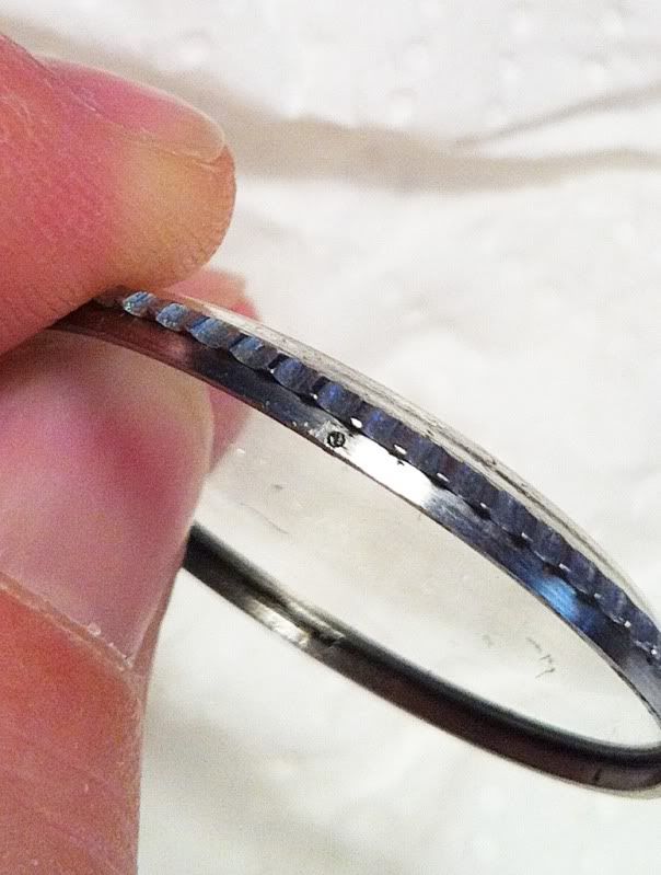

saabreit wrote:
For the bezel fixing system, a very thin ring - same dimensions than sliderule for compensing the vertical gap, and 3 radial pins to be adjusted from steel wire , which are inserted in the 3 holes of the bezel and come into the circular slot of the case . If you dis-assemble the bezel, you will have to replace those 3 pins . Some are replacing the pins by 3 taps.
Have I told you guys how much of an idiot I am sometimes? No? Well, let's just clear this up ... I AM AN IDIOT SOMETIMES!!
I have no idea how I overlooked these 3 pins all this time. Guess I thought it was dirt I just hadn't cleaned up yet. Whatever the reason, I completely overlooked them. Discovered them this morning just fiddling around with the case in anticipation of a dial find.
I can't find my macro lens to take a good close up, but under magnification, they look to be screws in mine. They don't turn so I'm soaking the bezel in Gumout to see if they will release. If not, how can they be replaced?
Here's the best pic I could get with my phone ...
