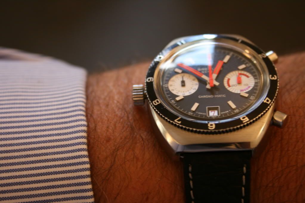

Flyingpan wrote:
Hi.
I do believe that the 2114 was a fixed ring only, that is why I was surprised to see that watch in the other thread.
Both versions of the 2114 were available, just received my 2114 (in quite nice condition) with a rotating bezel:

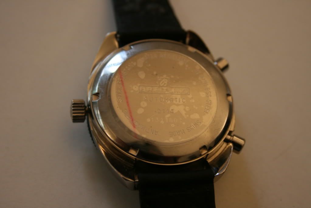

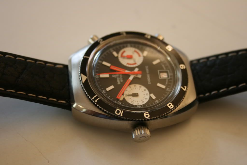

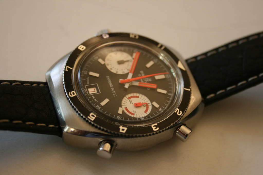

Although the crystal on the OP's 2114 appears to be slightly tall, it might be because we are looking at it without the bezel attached. It might be correct for the watch. The crystal on my 2114 would look tall without the bezel.
To my knowledge, the only way the crystal would prevent the bezel from attaching is if the bezel inside diameter is smaller than the edge of the crystal. I think the watch repairers would have noticed this. It should be easy enough to measure. Looking at mine, it appears that the inside diameter of the rotating bezel just covers the metal portion of the case: It seems as though the crystal is straight up from where is sits in the case.
Here are shots of mine for comparison:
As Fred mentioned, I think the 2114 came with both rotating and fixed bezels. In fact, if anything, a rotating bezel was standard for the 2114. I have not yet seen a fixed-bezel 2114 but many 2112's have fixed bezels.
I always thought that the case for the 2112 and 2114 were the same. Perhaps yours has a 2112 case?
The only other answer I can think of is that possibly the original bezel was supposed to be fixed on your watch and the rotating bezel will not hold. Other than that, either Breitling mis-labeled the bezel or something is damaged that prevents the new one from being attached.
