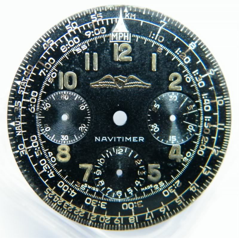

from what I can see the #23, 24 & 25 look to be hand painted on the ring ?, specially the lower half of the 3 in 23 seems smaller than the upper half but might be down to wear.
Also the dial looks repainted , less 'crisp' and the numbers are 'thinner' when compared to an original dial ,
and again the 3 in 1:30 above the 2 o' clock marker , the lower side seems smaller than the upper side of the 3
the 10th second markers not properly spaced (not equal distance between all markers)
and the 'swiss made' seems to be missing ?
the word 'Navitimer' doesnt seem right either , incorrect and inconsistent font
here's an original dial so you can compare and you can see what I mean
and the movement seems from an earlier watch with the single line on the bridge , but I need to have a look at my documentation later today to make sure
As said, I would need better pics to be absolutely sure

Not 100% sure either way on the dial, I think that the outer slide rule is non Breitling and the font is a little different.
PostPosted: Sun Jul 31, 2011 10:52 am
Posts: 496
Liked in: 78 posts
Dial & sliderule has been redone, and I am absolutely sure.
