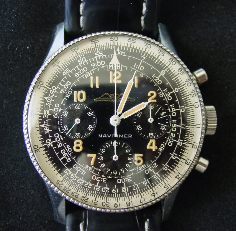

Watch out that you don’t burn your fingers, I have seen redone numbers & markers that was so well done that I hardly could see that it had been done at all.
If you buy one with redone markers / numbers the collectible value of the watch goes down the drain.
Here's one of the best made examples I have ever seen.
Kurt B
Kurt B

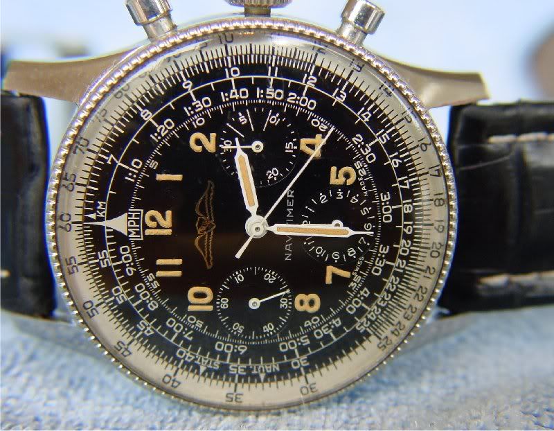

PostPosted: Thu Feb 17, 2011 2:17 pm
Kurt B
Thats actually one of mine :-) (I think ?, looks very similar)
edit.. no its not. this is one of mine :-)
but if anyone know who can that sort of a relume job I am interested , I have an old AVI & 806 dial that would maybe benefit from a relume

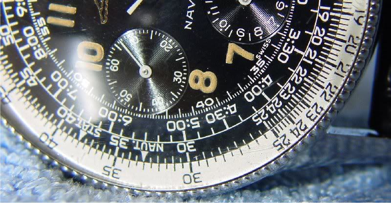

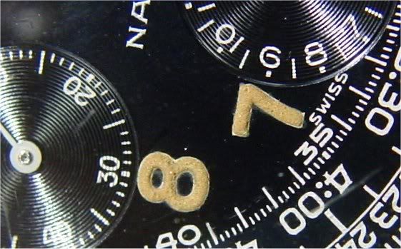

PostPosted: Thu Feb 17, 2011 2:58 pm
now I am confused.. it really does look like one of mine... I even have the same pic in my folder , serial number 871713
Kurt.. is that a pic of one of my watches , or yours ? .. or am I starting to loose my mind ?
here are some close ups
PostPosted: Sat Feb 19, 2011 8:20 am
Posts: 496
Liked in: 78 posts
It was a picture you sent me long ago.
