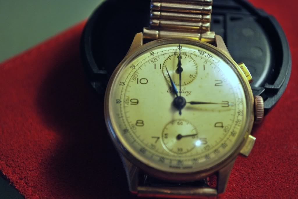

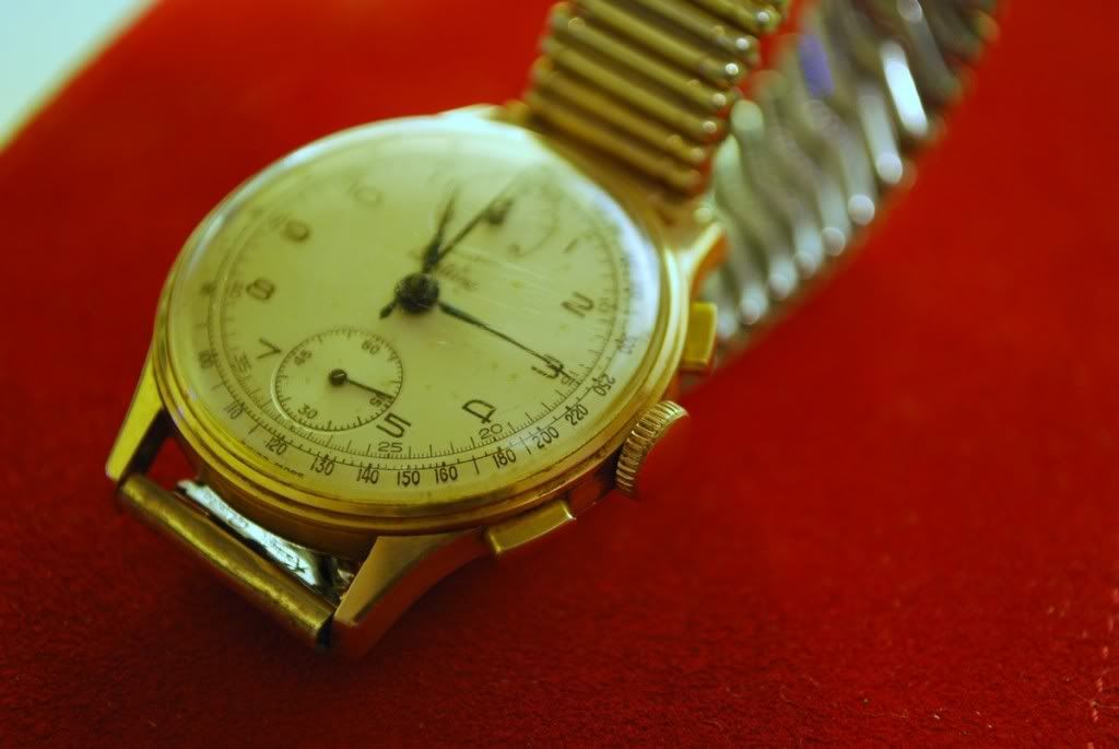

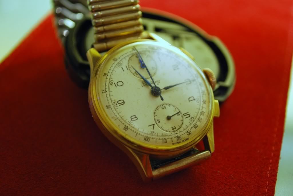

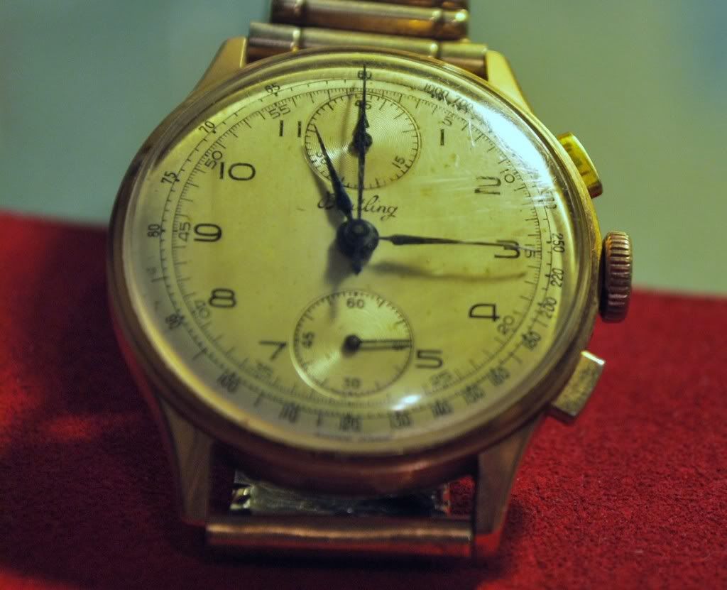

Here is my question, I recently aquired a 1946 Breitling, Rose Gold. Would really appreciate it if someone could give me some info on it. The watch is in overall ok shape, glass has some minor scratches. Do you recommend replacing the glass or leaving it the way it is, is it even available (replacement glass/crystal)? Is there an approximate value or the watch, tried finding it online, but didn't have much luck finding this model for sale/sold. Not sure if I will be keeping it or selling to but the Super Avenger I wanted for a while. Sorry for the bad pictures.

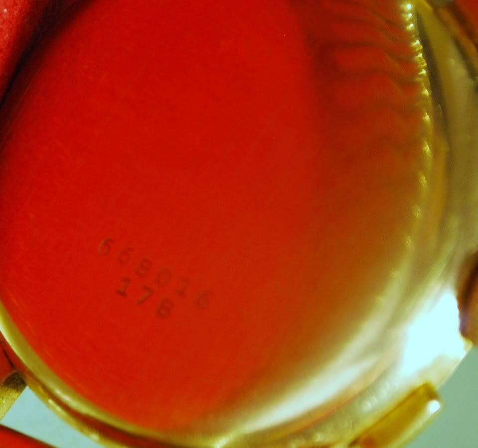

178 is a fairly common model, Venus 170 powered, in this condition, and with current gold prices it is probably around $1,200 - $1,500 if the movement is original.
We have a member here, chronodeco (Craig) who may be able to assist with servicing / restoration and can source a new crystal for you - these plastic ones are consumables so no reason not to replace. That said, if you are going to sell you may not get servicing costs back.

I would replace the glass as well... they're dime a dozen (at least for models like this) and it'll spruce up the piece really nice...

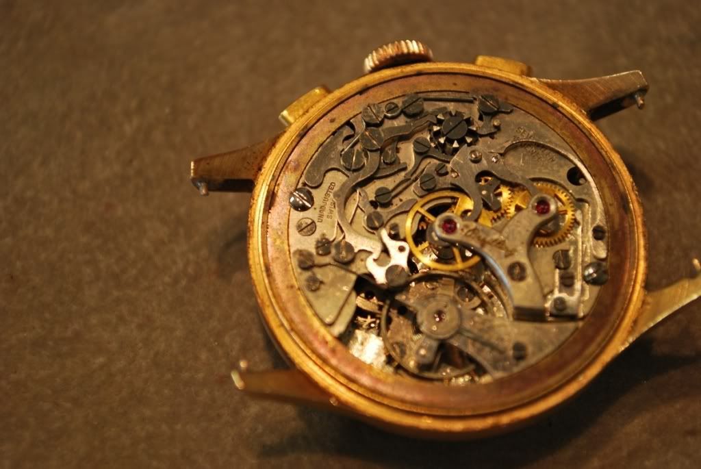

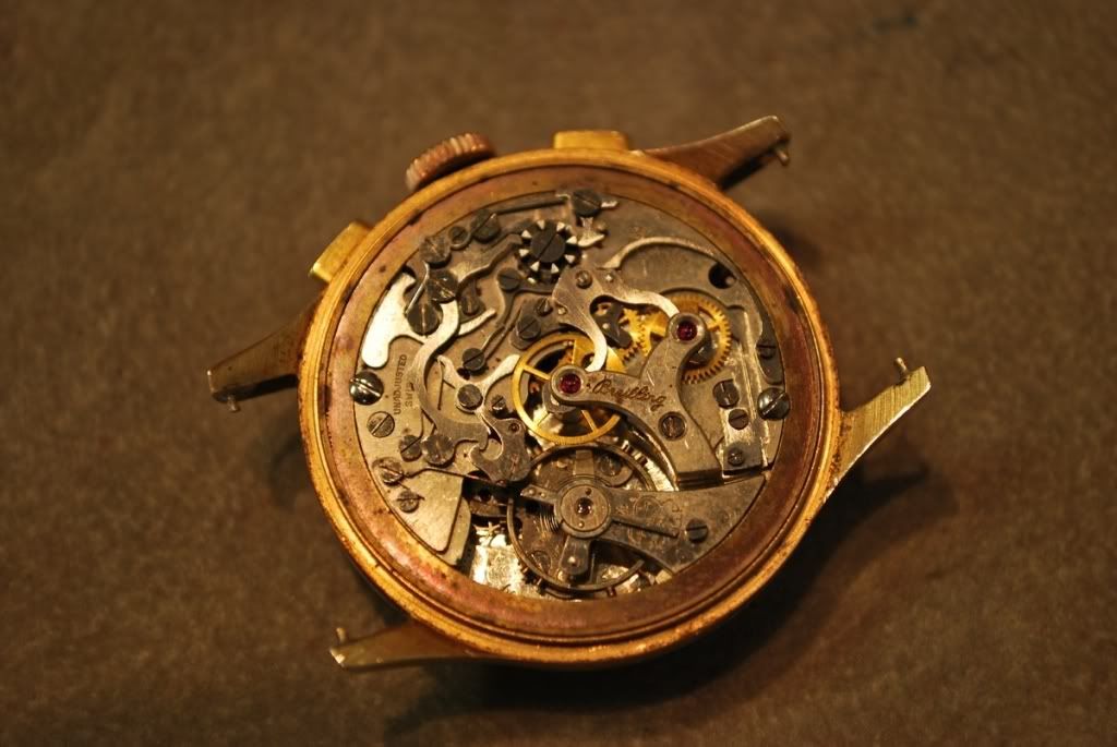

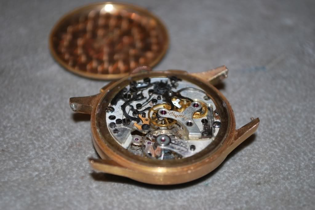

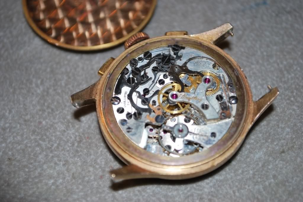

Just came back from the shop, asked him to open it up and tell me what he thinks. He said he recommends to have the watch overhauled and needs a new main spring, he was recommended to me, but still have doubts in his prices, for the overhaul he wants around $300, and he said he will call me with a price for the spring, he said that the glass/plastic can be buffed as the scratches are not deep. Does he sound right, I think the price is a bit high, please advise. Posting pictures as promised.
PostPosted: Tue Nov 02, 2010 3:00 pm
Price is a little high for just a service, although not ridiculously so. The watch looks dirty, but not awful, mainspring should be replaced as a matter of course anyway. Movement looks right and complete. Polywatch might bring the crystal back, but a replacement isn't that expensive.
I would certainly PM chronodeco and see what Craig has to say - his work is highly recommended around here and it won't cost you anything to ask.

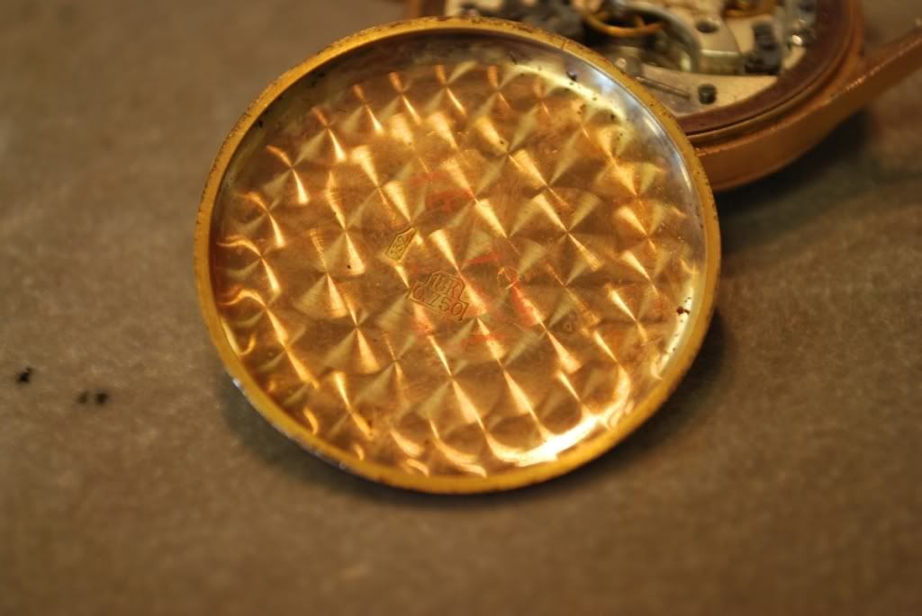

Common is relative - real Breitlings of this age are uncommon to start with, especially given the propensity for the South Americans to fake them (yours looks OK - the bridge is the only area of potential concern, but I think that the engraving is original).
Searching for these is also difficult because you come up with all of the Venus 178 powered Breitlings with three registers at 3, 6 and 9. Ironically the model 178 didn't have a Venus 178, it had a 170.

The thing with the Breitling on it - it's common to take non Breitling movements and engrave Breitling on them to try and increase value. I'm glad that I said it looked right as you have provenance :lol:
