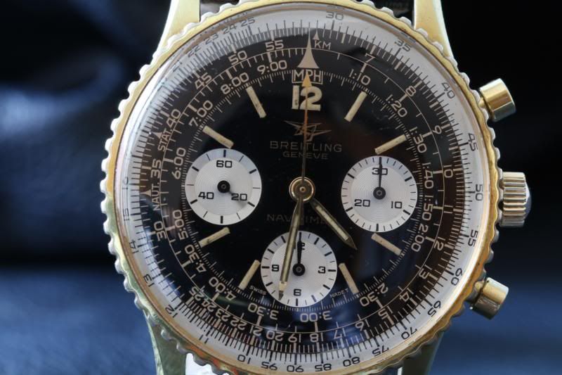

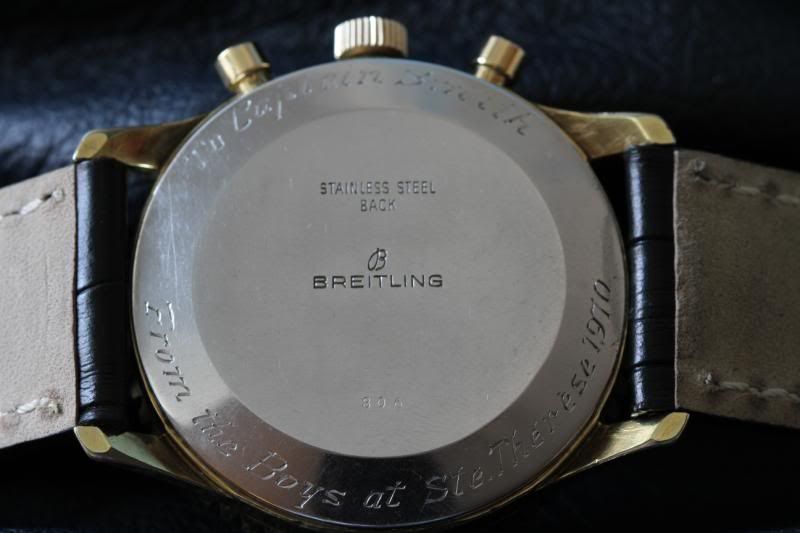

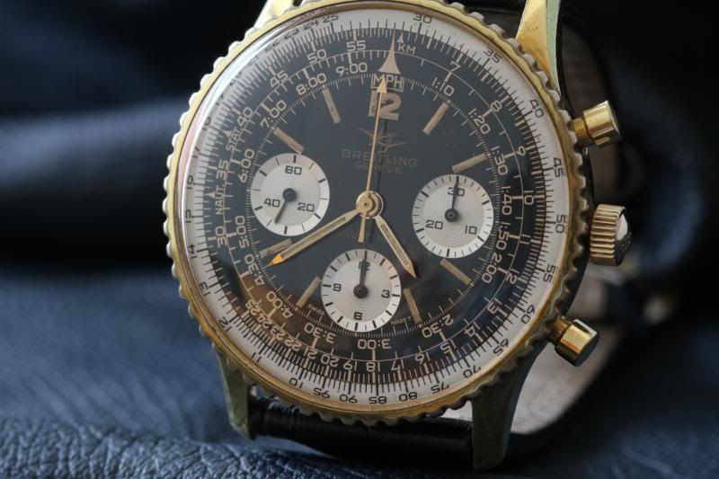

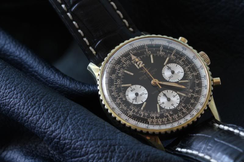

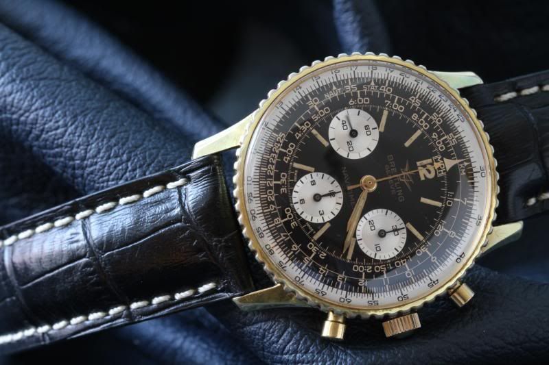

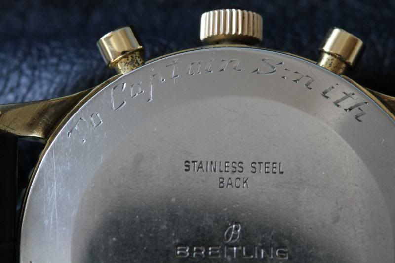

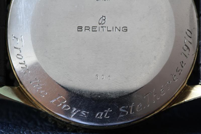

Hi Everyone,
My first post on this site, I usually hang around other sites as I am more into Panerai.... Nevertheless, Just last week I picked this up from my dad who had been holding on to this since my grandfather passed away. He knew I was a watch freak so he left this to me. He received it as a gift in 1970 from his flying friends when he moved from Quebec back to Ontario. As you can see from the inscription on the case back "To Captain Smith from the boys at Ste-Therese 1970". My grandfather wore the watch regualarly and I am almost sure he never had it serviced in the 40 years he owned it. The only thing I can tell that isn't original is the crown. When I last talked to him, he mentioned that one day while winding the crown broke so he took it to a local watchmaker who just put on what he had. The case is pretty banged up but the movement runs like a charm even after all that time.
I am too afraid to open the caseback so I have no clue about the serial number or exactly which movement is in it, although I would really like to know... ;-).. Anyway, here are some shots I tool on the weekend.
Thomas

I think that it's rather earlier than 1970. The movement is a Venus 178. It could obviously use a service, but other than the crown it looks to be in nice original condition - congratulations on a great watch and the story makes it all the better.

Thanks.... Without knowing the serial number, do you have any idea how much earlier it could be than '70? I know back in those days, they tended to sit around for a while before being sold...

My guess is 1966
Thanks for the info..
Thomas
Impossible to know for sure. There are a couple of indicators that this is earlier - the small subdials are common through 1967 / 68, but become much rarer after that and I don't recall seeing any 1970s with small subs. The more confusing thing though is the outer slide rule. To see one of these without any red on a piece even as late as 1966 is highly unusual. The problem in dating without serials is that there was no true demarcation - more transition over several years. There are some general rules - red box around the 10 on the outer slide rule is usually 1967 for example, but other than that it's tough. Also, when pieces were serviced the outer slide rules were often replaced due to fading.
Given that the watch was a gift in 1970 (presumably nought new at that time) I am tempted to discount the black slide rule which could push it back to as early as 1962 or so, and say that I don't believe that it is any later than 1968, and if you forced me to guess I would say 1966.
Edit - Kurt beat me to it (and agrees).
