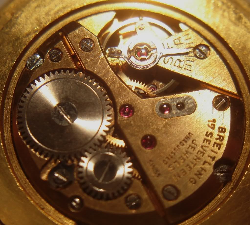

thanks a lot for your help. I asked the seller for a closer look on the last one's movement and he sent me this:
I was looking for a good Breitling chronograph, really like the Breitling design. I showed a lot of diferent styles just to try to learn about the counterfeits, I was hopping you guys could teach me how to identify an original Breitling.
Thanks again for your help.
 Post subject: Re: New on the forum
PostPosted: Wed Apr 07, 2010 3:25 pm
That larger photo helps, and it looks Ok to me. If the first digit of the serial number is a 5 (which I think it is) then it's a 1951. One thing I don't like about this is the condition of the screws on the movement - at some point a watchmaker who didn't care about his work has been allowed at that watch - even I can do better than that. That alone would put me off.
