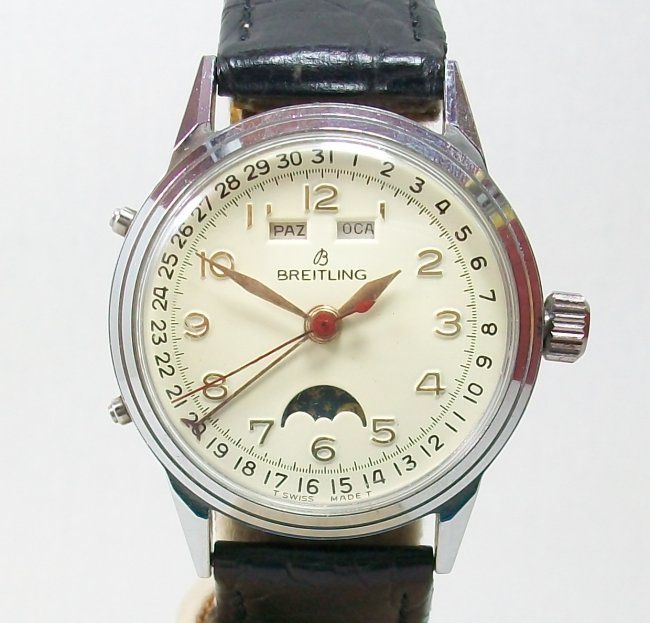

Hi,
I am new on this forum but fan of Breitling for years, having already a Montbrillant Eclipse and an Aerospace.
I recently bought on e-bay a vintage "Breitling" with Felsa 693 signed movement.

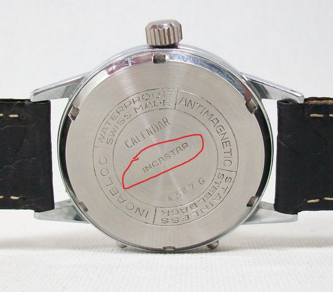

I always thought it is a fake. The back is definitiveley wrong but I know that Breitling used some Felsa 690, 692 and perhaps 693 in the 50's.
Anyway the movement works perfectly (+2s/d).
What do you think ?
Thank you.

Its a nice watch, but was never a Breitling.
 Post subject: Re: Breitling with Felsa
PostPosted: Wed Jan 27, 2010 8:49 pm
It's a shame, I think that this watch is largely original and someone has devalued it by scrawling Breilting all over it - taking a genuine, watch and turning it into something that it clearly isn't.
In the bay (http://cgi.ebay.de/OROLOGIO-ENICAR-AUTO ... 1c10131b30) there is a similar watch. Not ENICAR either.
Another watch (http://cgi.ebay.de/ws/eBayISAPI.dll?Vie ... 3D1&_rdc=1) seems to be very original, refusing to tell us the family name though.
Chris

tomvox1 wrote:
...if you're going to re-brand a watch, though...
...it's a good idea to scrub off the real brand first...
Tom,
INCASTAR seems not to be the brand of the watch but the name of a regulator.
Vide first pic in viewtopic.php?f=11&t=16407
Chris

Chris K wrote:
Tom,
Chris
...I guess this Incastar regulating feature could have been found in some Breitlings with Felsa 69x Bidynator movements then, so no give away on legitimacy in that regard after all (although did Breilting go that nuts with the caseback nomenclature in the 40s/50s?).
http://www.ranfft.de/cgi-bin/bidfun-db. ... &Felsa_693
Learn something new everyday (which is the fun of this hobby)--thanks for that!
Best,
T.

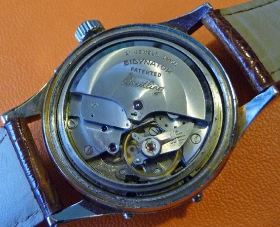

this watch is 100 % not Breitling,
but Breitling used the Felsa Bidynator calibre 692, 693 and 711
Last edited by breitlingmuseum on Wed Feb 10, 2010 1:59 am, edited 1 time in total.

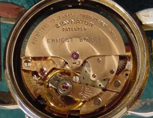

That looks like an Ernest Borel to me, and they used Incastar.
I don't think it is an Ernest Borel, the rotor would have been engraved ernest borel

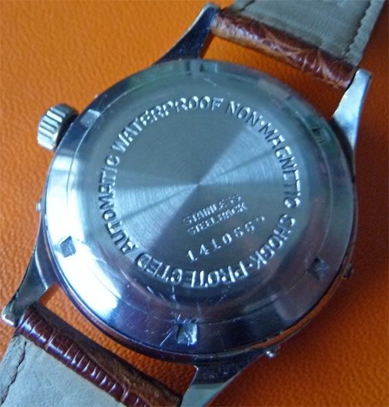

Here is my watch :
PostPosted: Wed Feb 24, 2010 5:29 am
Posts: 3335
Likes: 117 posts
Liked in: 414 posts
Not necessarily, it's quite common on the Felsa automatic movement rotors for them to say just Bidynator or nothing at all. I have seen Breitling Felsa's without Breitling on the rotor and many different Breitling scripts some of which might not be authentic. I would assume Borel would be the same way. The rotor is a very easy piece to swap out when replacing a movement so you can basically call the movement any brand you want by affixing the pertinent rotor but it's still a Felsa. :)
