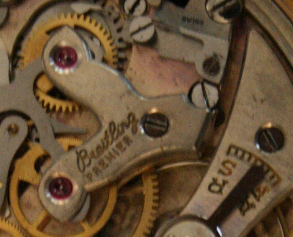

Guys, posting this in the engravings section for continuity, so this font engraving on a 1946 ref785 v72c is wrong? Are any of the above Valjoux movements? Were engraving styles on Valjoux movements different from those on Venus ones?

cruvon wrote:
Guys, so this engraving on a 1946 ref785 v72c is wrong?
it is surprising compared to other (assumedly correct) pieces of this period that have no bridge markings , but we probably have not seen enough pieces to say anything for sure.
the combination of script logo dial and capitals bridge is another issue that many doubt to be correct.
Thanks Fred, wonder if Valjoux sourced movements had different styled engravings compared to their Venus equivalents? Did the movement manufacturers put those engravings?

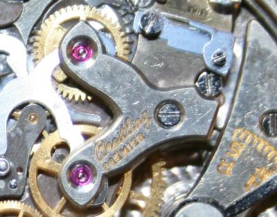

Here is a v72c movement on a 785 that has a suspicious font (it's even inverted compared to the previous watch example,see how the lettering is facing down to the concave in the other and to the convex in this watch)

PostPosted: Thu Feb 23, 2012 12:09 am
last example of a bridge engraving of the valjoux 23/72c is more than suspicious, might be an early work by the guy responsible for the 806 serial number mixup 14 years later ?
to get anything remotely resembling an answer we would have to add many more watches to our bridge engravings overview, but up to now all 45/46 Datora we felt were above doubt had no bridge engravings.
what is the earliest "correct" Datora you have seen ?
Craig thinks engravings were "all over the board" and has kept no records, although looking at the beginning of a list above we see something like a trend; saw a SS 797 listed yesterday, "expecting" signed + Permier, was proven riight by the pic, so it seems to be case material and model dependent ?
