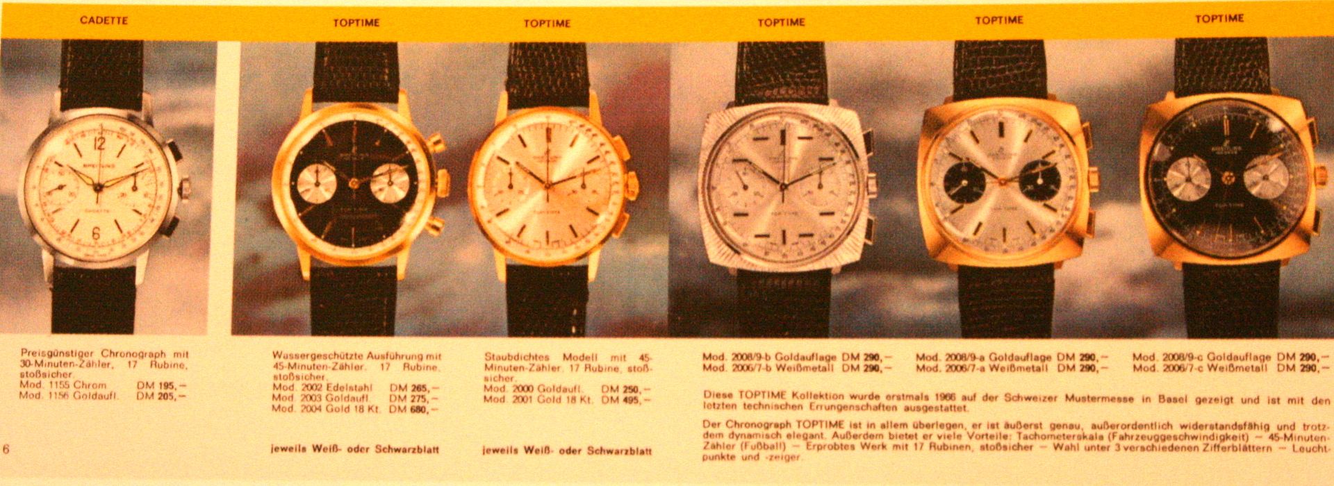

I borrowed this pick from someone a while back but it just lists white metal.
 Post subject: Re: Top Time 2006
PostPosted: Mon Jun 11, 2012 3:52 pm
That does imply some kind of plating - nickel, chrome??
They might actually all be that way but I've not had one in my hands before to tell. I think maybe Watchfred might have one and maybe can enlighten us.

They are all plated base metal, either gold or chrome, as the catalog says, "Weißmetall" literally translates to "white metal",
but stands for chrome plated, as opposed to "Edelstahl" - stainless steel. There are no "Edelstahl" or solid gold versions of
the Tonneaus and they easily show brassing on the lugs.
The Tonneaus were first shown at Basel 1966, yours is one of the early pieces w/ the V188, though 1967 is quite late for the WOG marking -
it is the first 2006 I have seen marked like this.
@Roff: I thought "Plaque xx" stood for the thickness of the plating in microns, 10, 15 or 20 ?
here is another Trautmann catalog page, late 60s:
