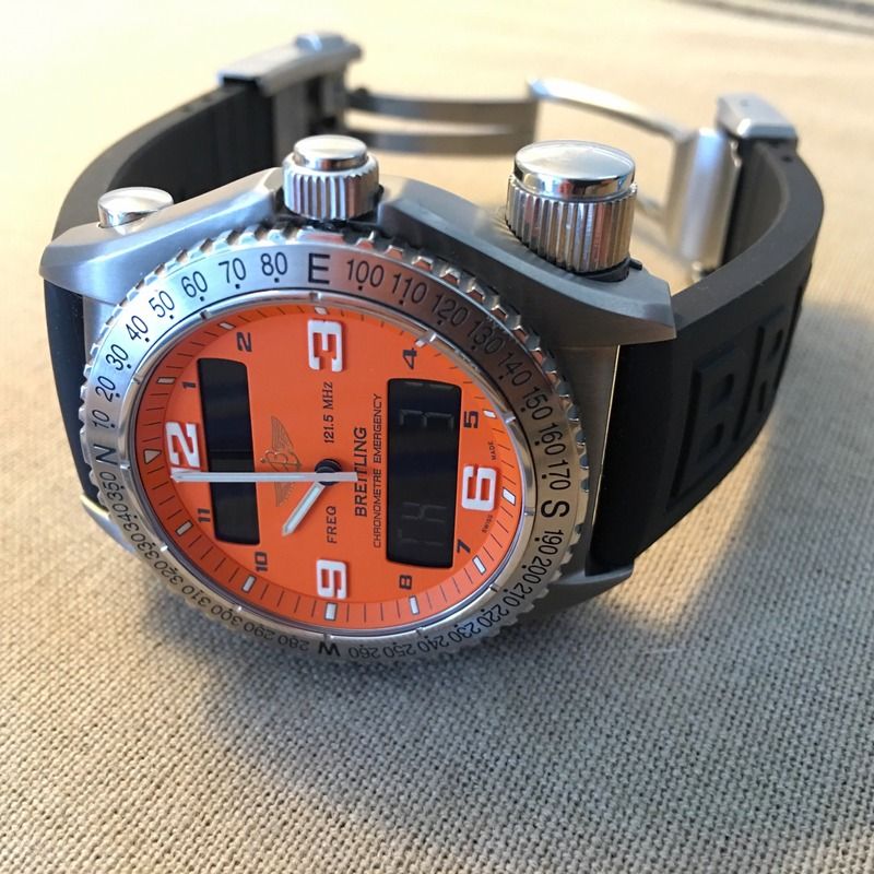

As Roff said, not obsolete. I work as a helicopter rescue doc, and have tested mine (using the test button) with our helicopters' search and rescue radio - works perfectly fine (although the pilots hate it!)
Here's some pics of it from last night, mixing it on on an emu strap this week.ImageImage
