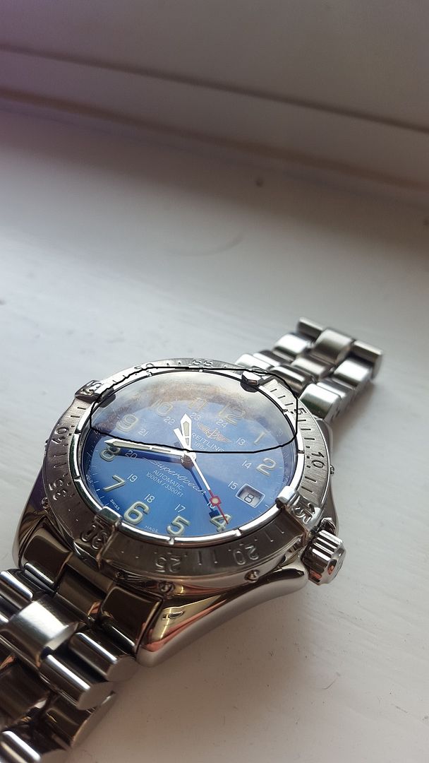

I've just bought the above watch and have noticed when in outside light only at certain angles I can notice what could be described as clouding in certain areas. Think it looks like it's on the outside of the crystal. It's not fogging but cannot be wiped off. Is it to do with the anti glare coating being old? That's if this watch comes with it. I was told it is the original sapphire crystal on the watch so it probably around 15 years old.
How much would it cost in the UK to have it replaced?

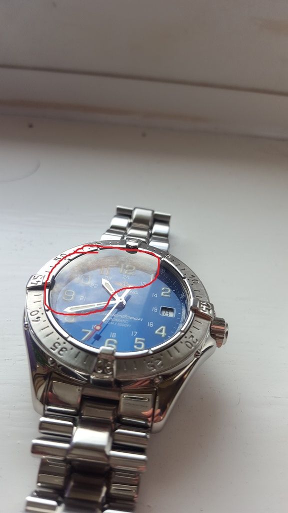

Thanks for the replys, I've added some photos. Click for full size.
The reason I think it's the AR coating is that it's perfectly worn off around the outer rim of the crystal were I suppose it would wear on clothes most of all with the odd marks in the middle along with patching.
Can you confirm from the pictures?
If it is the AR coating I will just remove the outer layer completely so at least there isn't the patchy clouding effect there is now, but doing so I don't want to scratch the crystal, this isn't possible is it?
PostPosted: Fri Jan 08, 2016 5:22 am
If you use Polywatch or Cape Cod cloths you won't damage the underlying crystal at all. Synthetic sapphire (or corundum) is incredibly hard and scratch resistant so anything short of diamond (and a couple of other very hard specialist materials) won't mark it at all. Polywatch is most often used for polishing plexi/Hesalite cystals so they have to be gentle. Cape Cods are a little more abrasive than Polywatch but are still pretty gentle, and will certainly not mark a sapphire cystal.

The "warning" is basically only saying that it's not abrasive enough to remove scratches from mineral glass, not that it will damage it. And sapphire is much harder than mineral glass anyway.
It may be able to remove very faint swirls from polished SS, but I've never tried personally. I use Cape Cods for that, and they do an excellent job (with a bit of elbow grease).

I had this on a SuperO many years ago. The cause was a previous watchmaker had polished the case with the glass in and caught the inner anti reflective coating with the buffer... Drove me mad till I worked out what it was.
