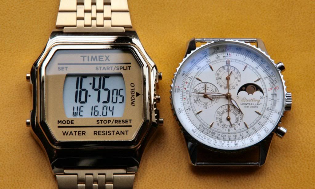

First picture, taken about 5 seconds after the Monty was sync started with the Timex at 16:45:00, nothing strange here.
The small hand at the top sub dial shows seconds.

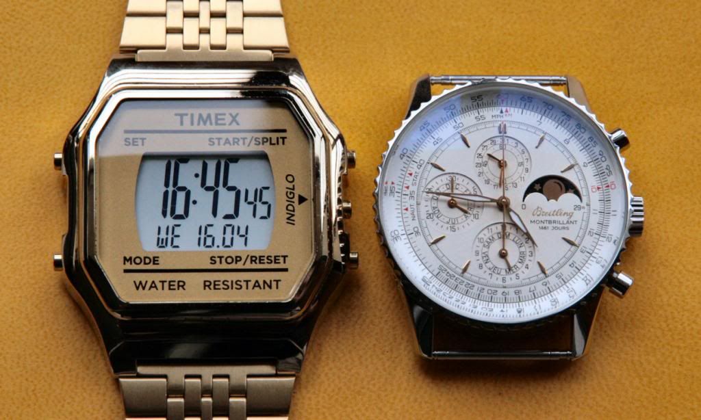

The second picture taken at 16:45:45 (45 secs after sync start)
The Monty is taking a clear lead.

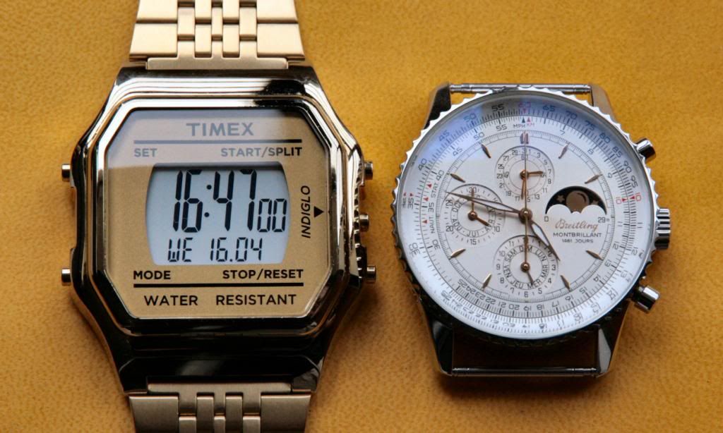

Third picture taken at 16:47:00 (2 min after sync start)
Monty is 15 seconds ahead :-(

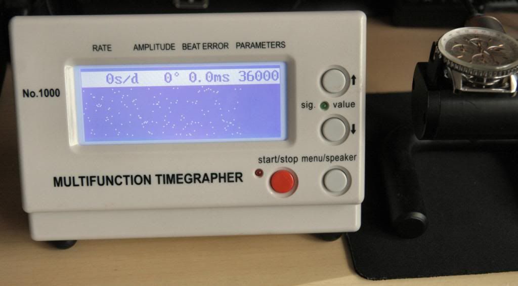

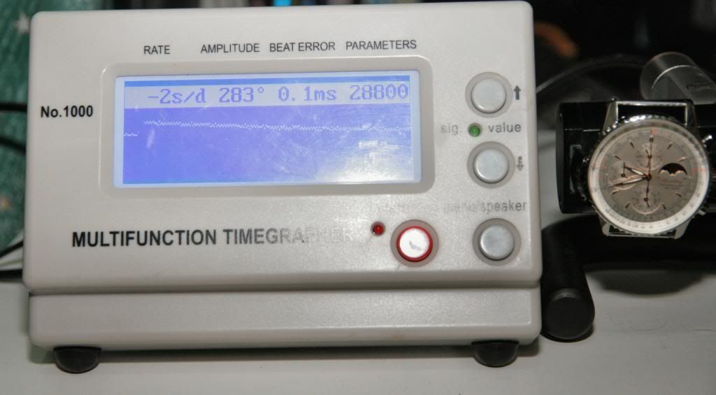

Now lets put the baby on a timegrapher before anyone tries to suggest that the Timex is running slow.

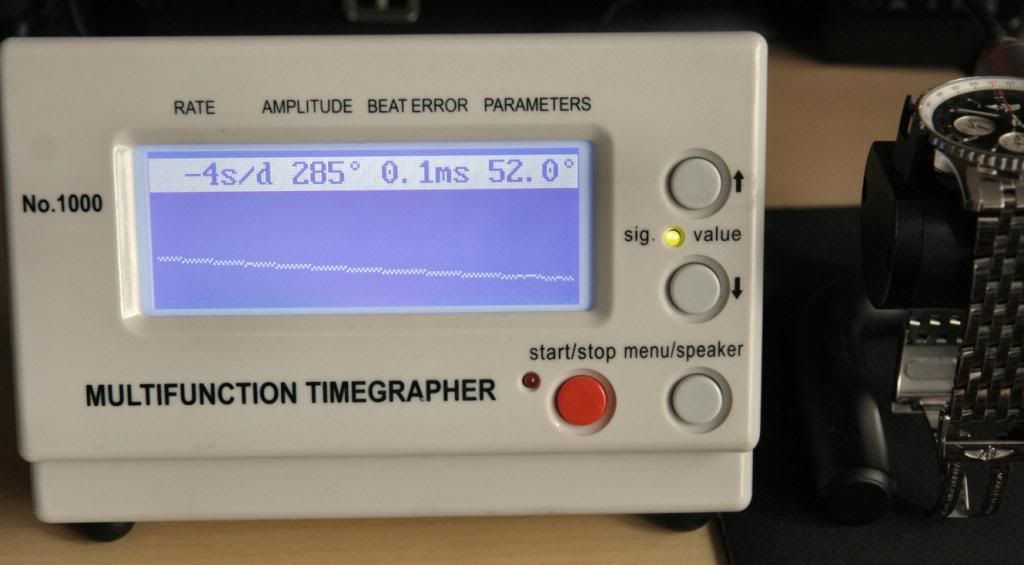

Of course we can not put the Timex on a timegrapher so lets put my Navi 01 on it first just to make sure the cheap toy works OK-ish. The cheap toy here being the timegrapher not the Navi 01 :-)
Looks OK to me.
The Monty however is clearly all over the place and even showing a beat rate of 36,000 BPH (!!!???)
It is definitely going back tomorrow :-(

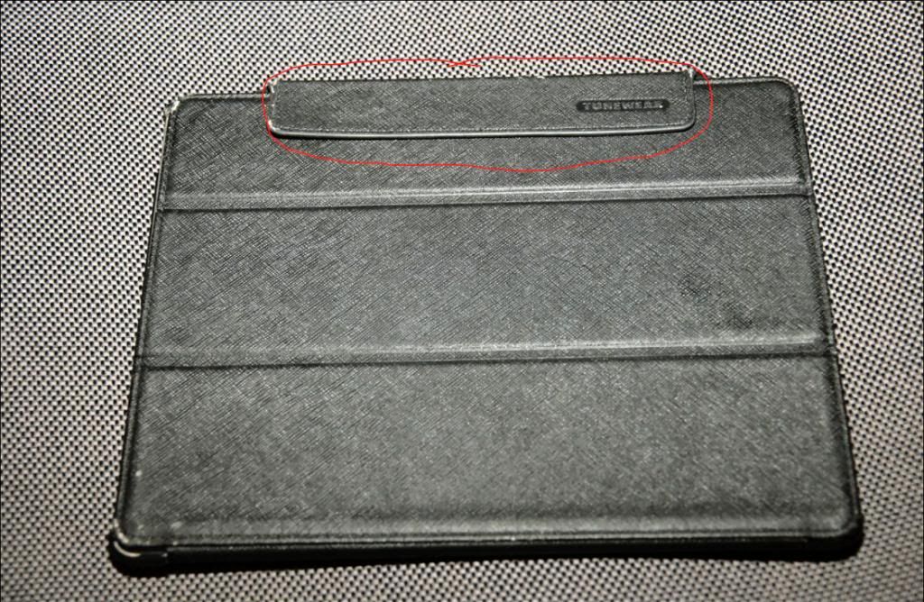

The Monty spent several hours today in my bag, right next to my iPad.
My iPad cover has this flap with a magnetic strip inside it so that when the cover is closed, the iPad goes into sleep mode, screen turns off, etc..
I even remember posting pictures of it some months ago here advising not to place their watch on top of iPads on their bed side tables for the night :uplaugh: :uplaugh: :uplaugh:
