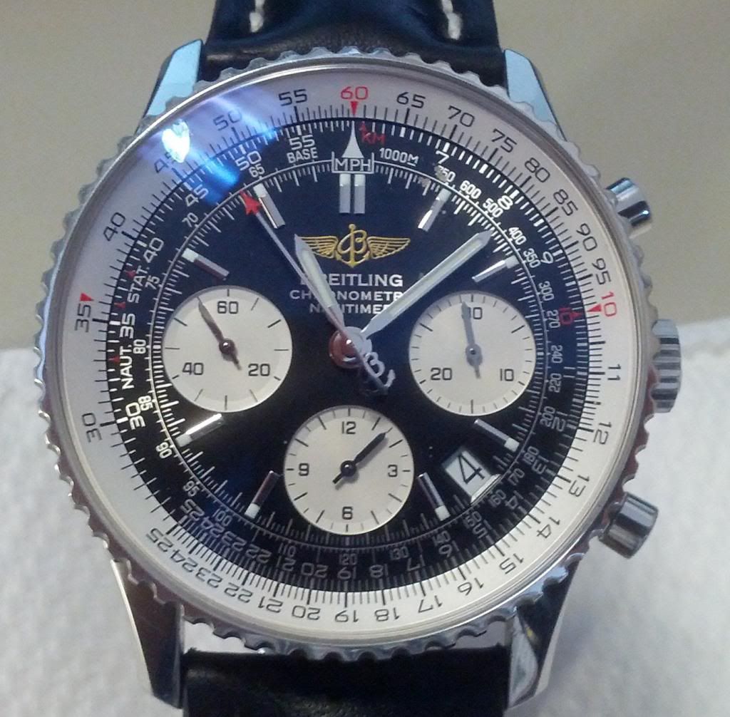

Here's a pic of my Navi (should have cleaned the crystal first I guess). Which scales don't align?

You can see in mjfur's photo - when the 60s are lined up the 10s are fractionally off.

This misalignment is not uncommon with Breitling and many other makers’ offers on SRW. If you look at Art Simon's Slide Rule Watch website, he has an explanation of this. http://sliderulewatches.yvod.com/
The two Scales C, D are single decade Logarithmic scales and are matched as a pair before installation. That is, there is a tolerance that is acceptable, and outside this, they are not acceptable. It would appear that watch makers in general apply their own rules to what the tolerance should be. Sinn, Anonimo, Tag Heuer and Breitling would appear to keep fairly close tolerances, where as others are less so.
There is no clear way of describing the inaccuracy that I know of and it is sometimes hard to express. Each Graduation line on the scales can be described as a ‘thickness’ and the amount of inaccuracy can be determined as a proportion of that thickness. Art uses the term ‘Tick’ to describe it, which seems reasonable as a nomenclature. So if the graduations at 10 or 60 are 3 time the graduation thickness, then its 3 ‘ticks’ off being accurate.
I once had a watch direct from the maker that’s C,D scales were 7 ticks off at 10, when 60 was aligned. This made accurate calculations almost impossible. To their credit, they paid for the return of the watch and a complete replacement, quickly and with profuse apologies. I won’t name the here, but it wasn’t Breitling………….
Some watch designs places the two scales with a separation. Art and I believe this is the last refuge of the scale rule scoundrel, as it’s easy to become a little lax on the tolerance. Inverted scales, such as those found on early Chronomats can be measured too, but it takes a real calculation to do this. You can’t just line up the scales - as one is inverted and makes no sense like it does on a Navitimer.

Herewith a picture of my Montbrillant. I matched 60s, it's very noticeable for 45s,40s, 35s and 30s
Please your comment.
PostPosted: Fri Apr 05, 2013 5:13 am
Posts: 1536
That's not very good. Best way to test the accuracy is to do some simple tests. Try some multiplications & division sums. It will become obvious when you see the amount of error that occurs. I think at worst this is about 1.5 ticks off. Not great really. Not much that can be done, as it relies on a matched pair of scales. The likelihood of getting them & the cost of the change over would very expensive. If the watch is under warrantee & the consumer laws in your country allow, you may be able to get it fixed through your local AD, providing you bought there. I see this on many occasion & its disheartening.
