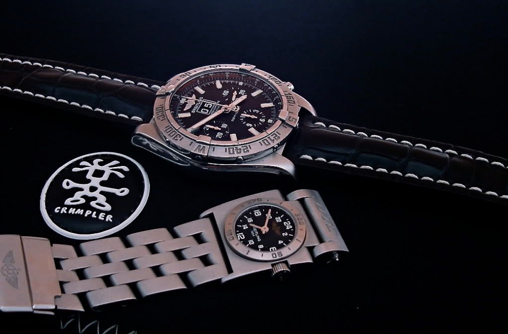

I have my utc and bracelet brushed to match my big date BB (BB+). Brietling would not touch it, and when it goes in for a service the original bracelet will go back on to save the brushed finish being (restored) to its origional polished finish.

That is crazy! (and not cool on BUSA's behalf). To be sure when you say BB you mean Blackbird, right? That is so weird given it comes in both a brushed and polished finish. A few months ago, one of the people at BUSA even told me they could refinish it to polish if I liked (I didn't, but was curious)...maybe it depends on who you speak to and how strict they are??? :?:

Alan is in the UK, so BUSA's position isn't relevant, it's BUK.
