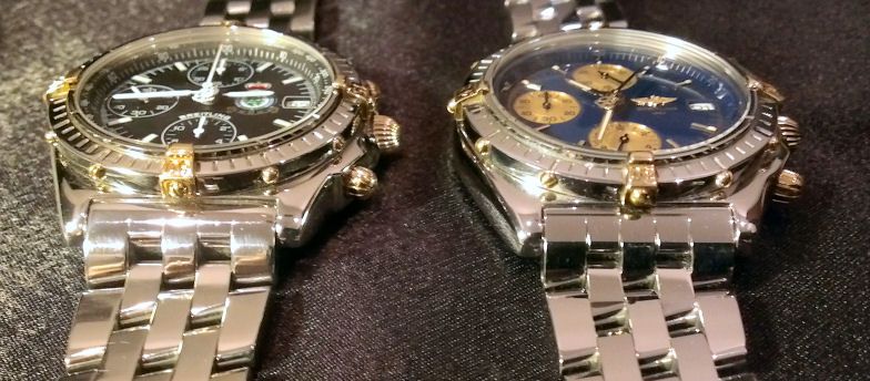

I have two Chronomats 13050, one with the original 300a bracelet and one with a 361a from a Cockpit.
I can not tell the difference between the two bracelets other than the ref numbers.
