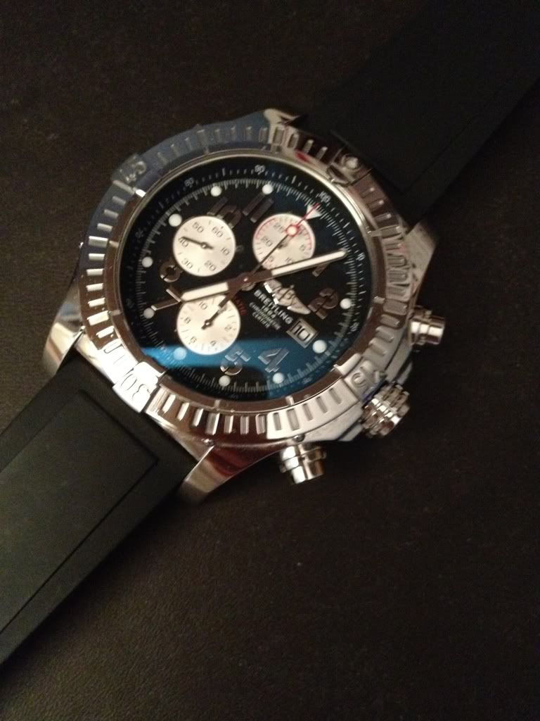

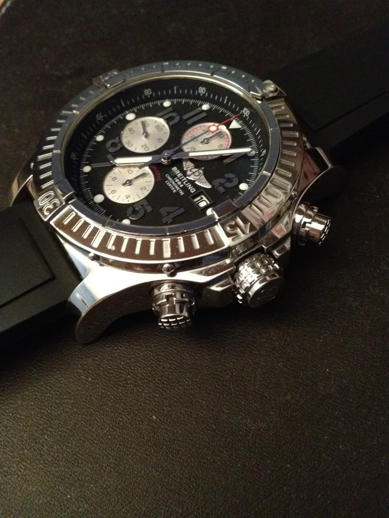

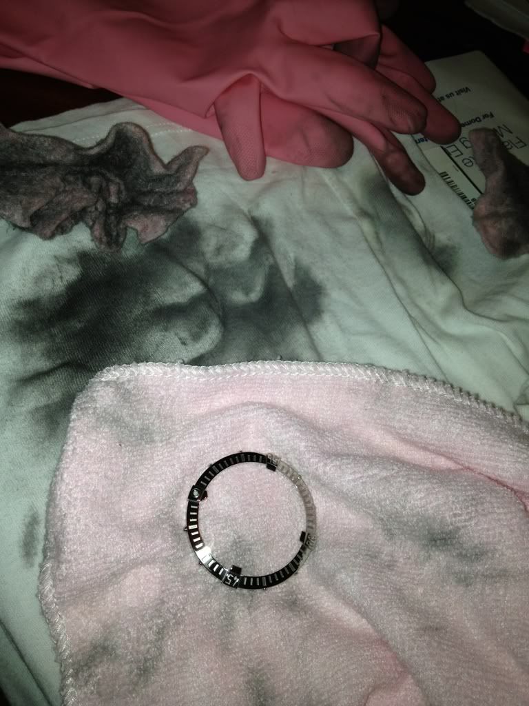

Just thought I'd update this thread and post a few pics for anyone who might be considering doing the same thing.
So after spending just under an hour polishing my bezel with a cape cod cloth, I am pleased with the finish. Not perfect, as I couldn't get into the marker grooves with just the cloth. But overall the bezel now matches the rest of the watch (I was never a fan of the two tone effect tbh).
iPhone pics only

I think that looks good :D when polishing, did you remove the bezel from the watch or polish it in situ ?
PostPosted: Fri Jan 13, 2012 3:59 pm
Joined: Sun Aug 08, 2010 5:12 am
Posts: 116
Location: London, England
Yep removed the bezel. Takes less than a couple of minutes.

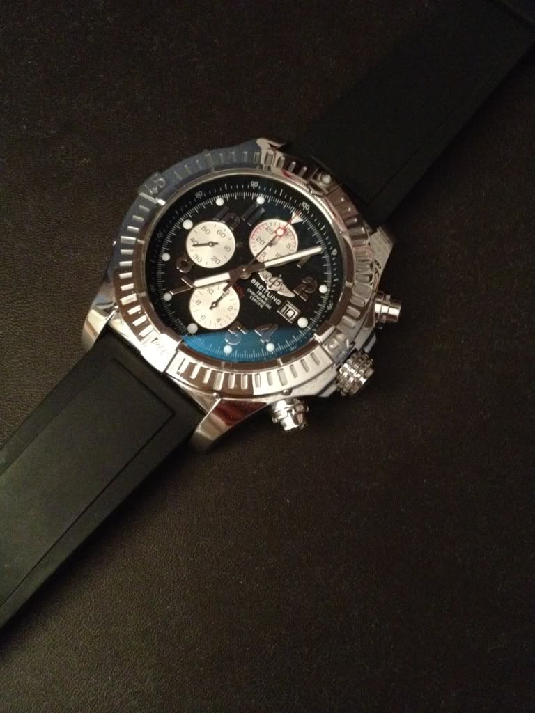

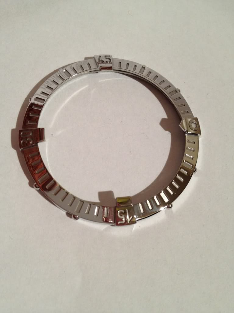

mrcheatle wrote:
You have photos of it polished?
Those two pics above are of it polished.
iPhone pics don't really do it justice tbh, but in the flesh it's as shiny as the rest of the case.
A few of it freshly polished.
Would probably get a better finish with a dremel tool or getting an AD do it, but am satisfied with the finish from a £5 cape cod cloth and a bit of elbow grease :D
