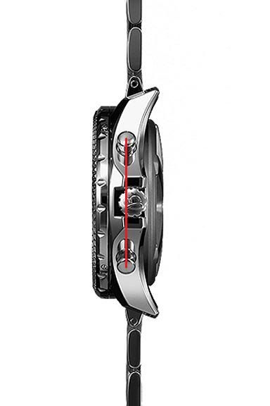

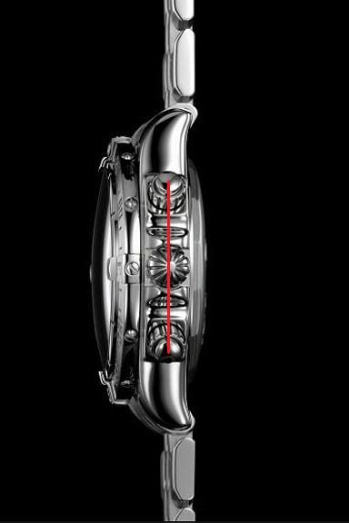

These are side shots from the 360 view on the Breitling and B4B websites. The perspectives may not be identical, but I'm not really seeing the offset on the BB (if it's there, it's very slight), whereas it looks pretty clear on the 6.75.

Yes, thanks! That's what I'm talking about. On the BB, it looks like it's all in one line. Strange. Wonder if they figured out how to relocate the stem even though the movement is modular.
PostPosted: Thu Jul 12, 2012 4:04 pm
Just look at the difference in the size of the pushers, no reason why the push rod has to be centred. It's a modular movement, they're offset.
