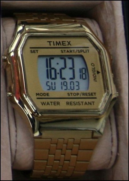

PostPosted: Wed May 30, 2012 12:12 am
Tombee wrote:
Seiko ±11 seconds per year."
That's pretty bad, my $50 Timex only lost 1 sec in the last 3 months.
Funny that, it's the "reference clock" for my collection :-)
