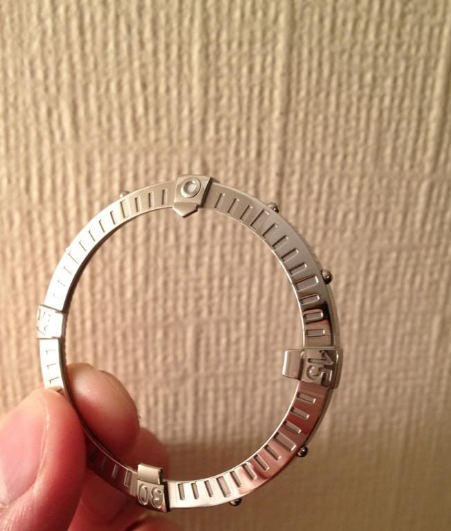

Just received my cape cod in the post, and going to attempt to polish the super avenger bezel to a mirror finish.
Any advice on how to get the best results from a cape cod cloth?
Watched a few videos on youtube, and most people wear gloves. Is the chemical harmful to skin?
Also, once polished, what is the best way to wash the bezel?

Most definitely wear latex disposible gloves! You will likely need a wood piece with a narrow flat edge to work the tight areas - for instance where the polished rider tab sits on the bezel. See here - http://www.ofrei.com/page633.html You can fold the cloth around the stick, getting more leverage in tight places.
Either remove the bezel, recommended, or carefully tape off the crystal. If you slip and the crystal is unprotected, you will wish you never started. :oops:

PostPosted: Mon Oct 31, 2011 8:20 pm
Joined: Sun Aug 08, 2010 5:12 am
Posts: 116
Location: London, England
Thanks for the tips guys.

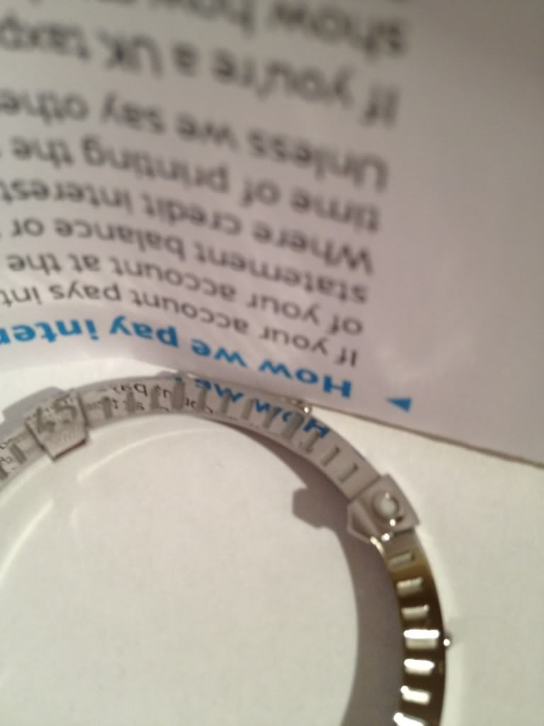

Spent about 45 mins on the bezel this evening.
Would have been better with a dremel tool, but still reasonably happy with the finish so far.
Definitely prefer it like this as opposed to it being in brushed/polished contrast.
Still needs another going over I think, and as Sharkman says, I need to wrap the cloth around something pointy to get to the areas around the rider tabs, and the tab with the lume on.
But fingers are a bit sore from all that hard rubbing, so will do it another time.
Just a quick question, I've buffed out the polish, but is it advisable to give the bezel a quick wash with soap and warm water?
PostPosted: Mon Oct 31, 2011 8:53 pm
nice work! I would wash the bezel in hot water and soap to get the caustic fluids off. Not sure it will do any harm to the metal, but anyway it stinks .
