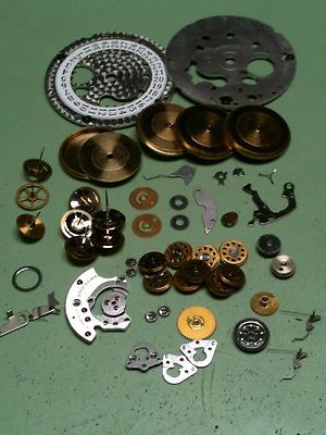

interesting listing of 01 parts on ebay, indicating quite a bit of 01 repairs ....
http://www.ebay.de/itm/Breitling-Calibe ... 0928727202
