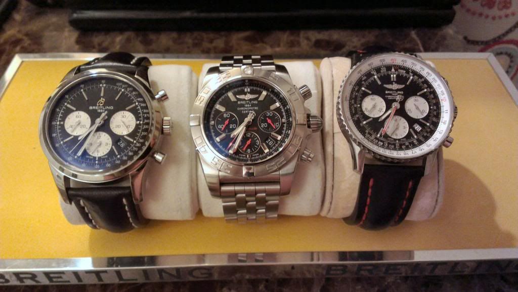

PostPosted: Wed Feb 27, 2013 7:27 pm
wessa wrote:
OK, the Chronomat, TOC and the Navi all fully wound, time synchronised and chronos activated also in synch for overnight check.
Update in about 8 hours.
Status report. Self explanatory.
Note: The Navi was started a couple of seconds later than the Chronomat and the TOC as I only have two hands and I don't think Mrs Wessa would be very appreciative of me waking her up at midnight and asking for assistance in starting the chronometer ;-)
Not the best quality picture but don't expect better at 7:30 in the morning.
I left the chronos running and will be checking again tonight.

PostPosted: Thu Feb 28, 2013 6:04 am
22 hours later, the TOC, Navi and Chronomat are still running perfectly fine with the chronographs on.
I guess I can conclude that all three are fine, for now at least.
